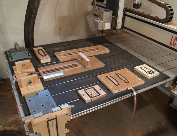

CA works good for making a one-off part or fixturing. A few small "spot welds" will hole amazingly well. Slip a knife under the part to break it loose after machining.
I use it also for some production parts being cut on aluminum fixture plates. I do rough the aluminum with coarse sandpaper though so the CA has something to bite into.

I always use some kind of fixture or scrap wood as a base. Carbide bits will cut aluminum although at wood plunge speeds a booboo can do a number on bearings in the router
I use a universal fixture base with all kinds of holes for dowels and threaded inserts to which stock is bolted to or sub-fixtures attached.
Rand Kennedy38964.4234143519

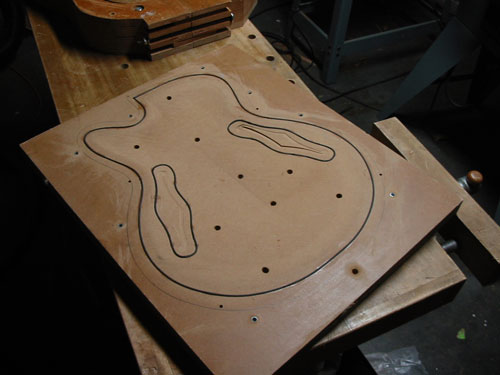

Paul, I was trying to discribe something like rand posted. He appears to using some vacuum also.
Here's a picture of an archtop vacuum chuck. It has a couple of holes to locate it on the table, you only see one as the other is blind hole on the back side. It uses 1/8 o-ring cord stock for the seal.
Hope this gives some ideas.

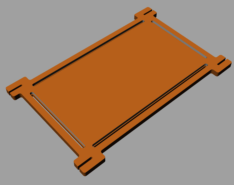

That gives me lots and lots of ideas, just what I needed , I created this in Rhino this evening and am fighting with Rhino-Cam to do the inner pocket edges:
I got it to cut all the other pockets just not the inner lip ones. Once I get that figured out I'm going to add some stuff like Rand has. The picture here is upside down, I was going to use some floating clamps in those edges to hold things down (if I have a free edge). I'll have to stock up on rubber gasket material
I was going to put the knobs at the end of mine but after seeing yours I might just change that and flush in some hex bolts. As I start to pull in more and more parts to the CNC I'll start making vaccum jigs, I already have one to clamp my braces so I have a vaccum source in the shop...

Here's a quick and dirty way to setup a repeatable fixture.
1. Take a piece that's plenty big enough for your fixture and drill holes in it for your t-slot table.
2. Bolt it down to the table.
3. Cut a clean edge down the left side and call that zero (don't forget the cutter offset and the fact that you're cutting in Y, but setting X)
4. Cut a clean edge down the front and call that zero.
5. Jog your spindle to a logical location for the part's datum and write the coordinates of that spot right on the fixture with a sharpie.
6. Set everything to zero.
7. You now have a way of finding that exact spot after the fixture has been removed and replaced by indicating the side (to make sure it's straight) and then edge-finding the side and front. Jog to the coordinates that are written down and reset to zero.
Viola!

Paul - I'm using 3/4" Garolite XX for the base but you just want something that doesn't move with humidity and need to be faced all the time. It's pretty flat but I use the middle hold-downs to help. It's flat enough that I haven't faced it yet but it isn't as flat as my table so I will some day. My base stays on the table and the positioning pins keep subfixtures exactly where I expect them to be.

John the one hanging off the end closest to the camera, what is it used for?

Paul, I don't have a fourth axis. The fixture hanging off of the table is for cutting tenons. It's hinged with Thompson bearings for a quick setting of neck angle. Works like a champ.
For your .25 pocket, just draw a line where you want the pocket and either run an engraving cut on it, or profile it with a negative stock offset (of .125"). Of course, it will be a more accurate width if you cut a pocket using a smaller cutter.
By the way, the four holes you see in that fixture are for all of the different sized truss rods that my customers prefer. I've turned indexing pins on the lathe that make for very little play.
